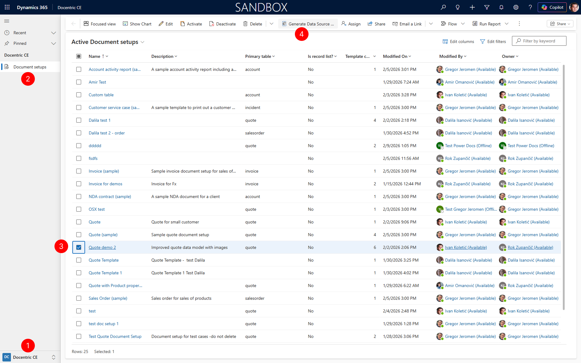

To start generating a DDSP file, follow these steps:
  1. In the navigation pane, select Docentric CE area.
  2. In the site map, select Document setups.
  3. Open or select the Document setup record for which you want to generate a DDSP file.
  4. On the ribbon, choose Generate data source. The Generate data source package dialog opens.
"Shows generate datasource action in Document setup view."

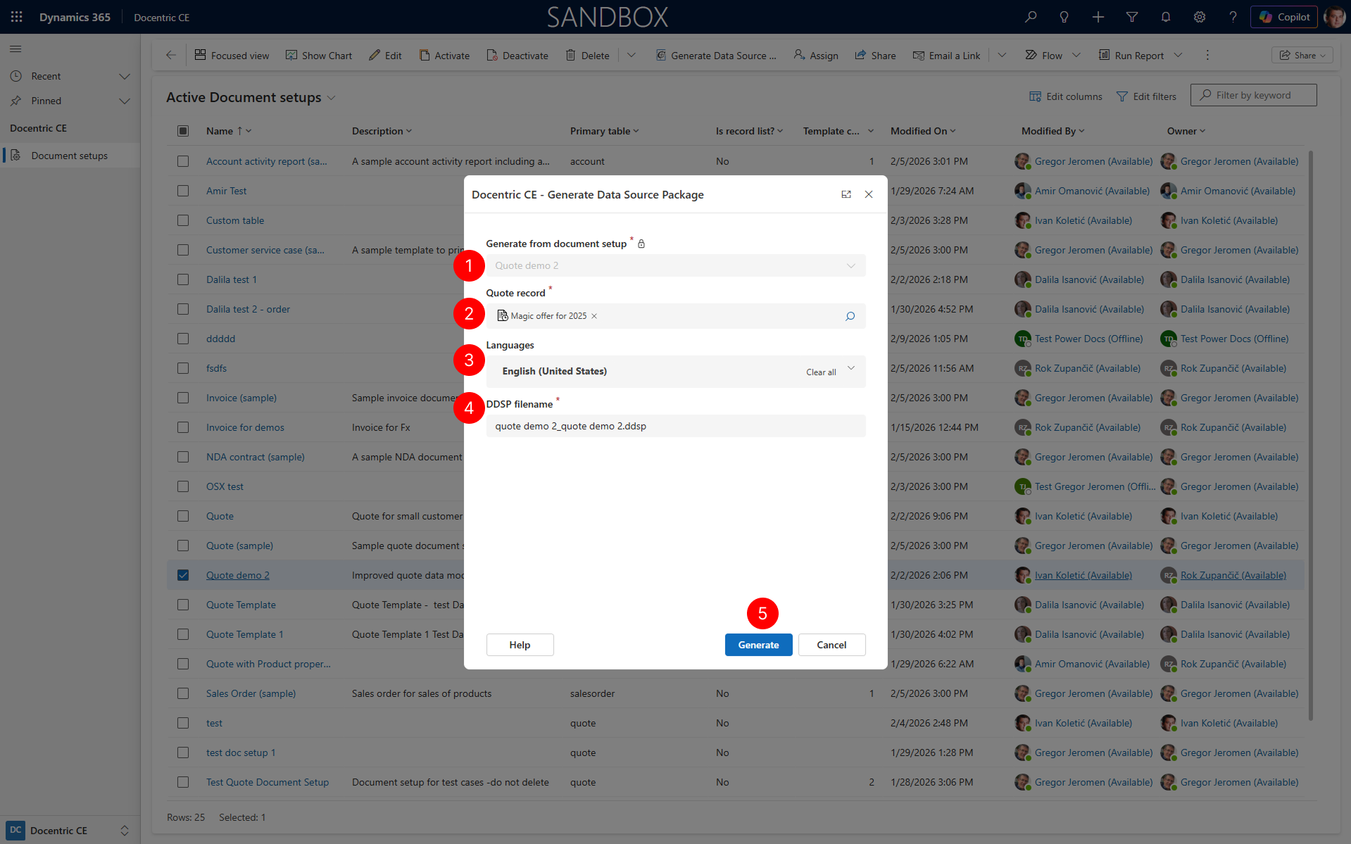

After opening the Generate Data Source Package dialog, configure the settings and generate the file:
  1. Review that the Document setup field displays the currently selected Document setup.
  2. In the sample data record field (for example, Quote record), select the record to use for sample data in the DDSP file.
  3. In the Language field, select one or more languages to include additional sample data and label translations for multilingual template preview. You can clear all choices but one if you don't need additional languages.
  4. In the DDSP filename field, enter the name for the generated DDSP file. The file extension .ddsp is added automatically.
  5. Choose Generate to create and download the DDSP file.
"Shows generate datasource dialog with generate action selected."
The DDSP file is downloaded to your default downloads folder and can be used by the Template Designer.
