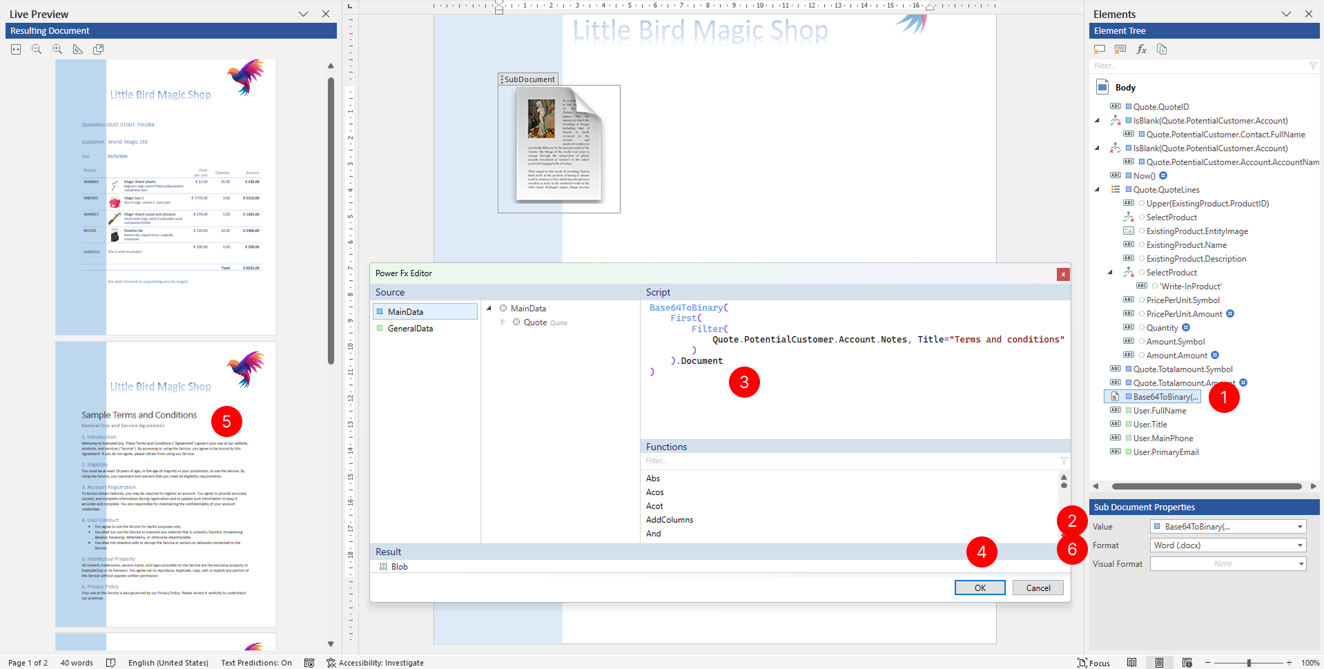

Select the Subdocument tagging element in your template or in the Elements pane.
In the Properties pane, select the Value property to open the value binding panel. To bind to a Base64-encoded field from Dataverse (such as a Note attachment), switch to Script view or Power Fx Editor.
In the Script field enter a Power Fx expression. For example, to retrieve a specific Note attachment by title:
Base64ToBinary( // Convert Base64-encoded document to binary format First( // Get the first matching record Filter( // Filter the collection of Notes Quote.PotentialCustomer.Account.Notes, Title="Terms and conditions" ) ).Document // Access the Document field from the Note record )TIP
If your subdocument is stored as binary data or retrieved from an external URL using the
DownloadFilefunction, you can bind directly to the field without usingBase64ToBinary.Choose the OK to confirm the binding.
Verify subdocument rendered correctly in Live Preview pane.
