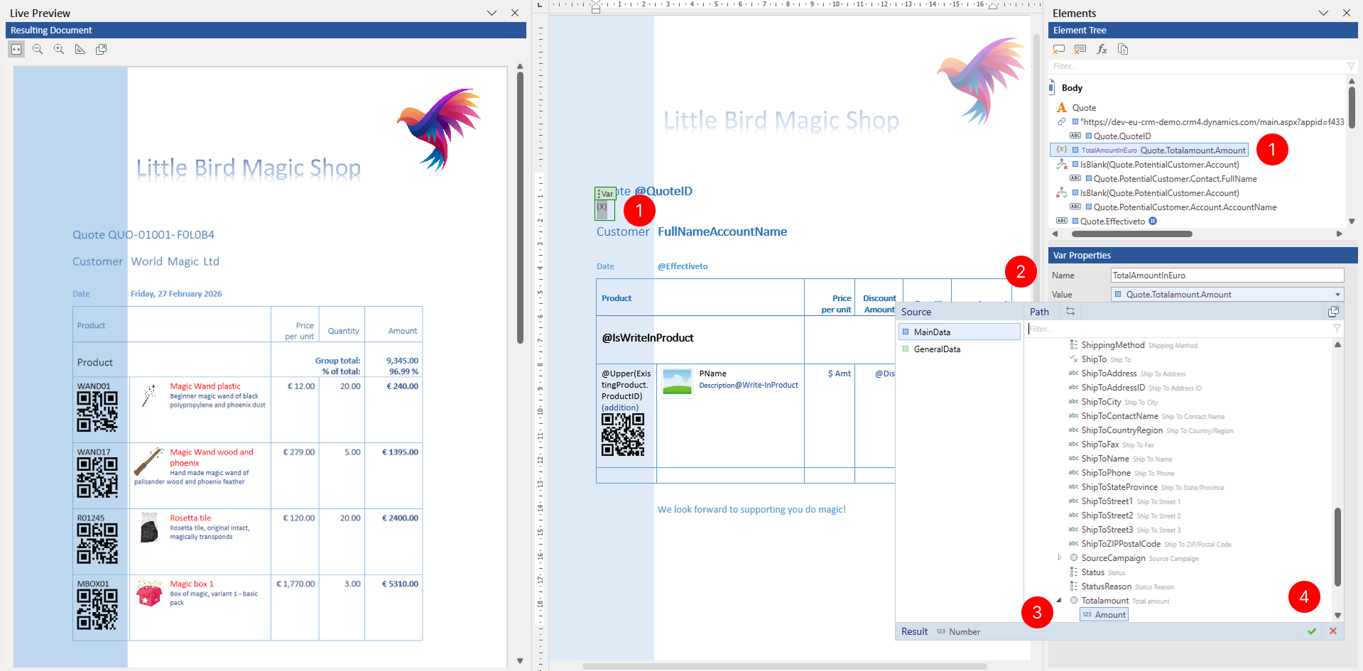

  1. Select the Variable tagging element in your template or in the Elements pane to view its properties.
  2. In the Var Properties pane, enter a descriptive Name for the variable that you will use to reference it later.
  3. Locate the Value property and choose the value button to open the value binding panel. Under Source, select the data section that contains your data. Under Path, navigate the data structure tree and select the data field, or enter a Power Fx expression that calculates the value to store.
  4. Choose the OK button (OK icon) to confirm the binding.
Elements pane showing a Var tagging element selected with Var Properties displaying Name and Value properties. The Value binding panel shows MainData as Source with a data structure tree for selecting the field to store.

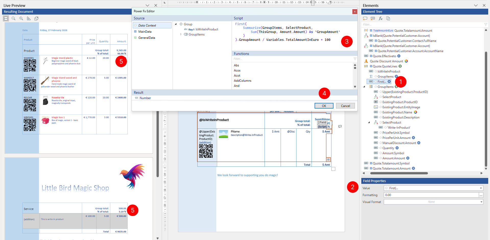

  3. Type a Power Fx formula that returns the value you need. For example, below is a Power Fx expression used in a Field tagging element within a Group tagging element that calculates the percentage of group total in total amount and uses previously defined variable TotalAmountInEuro.
    First(                  //Take first and only result from summarized table
        Summarize(
            GroupItems,     //summarize group items collection
            SelectProduct,  //summarize by Select Product field
        Sum(                //Aggregation function
            ThisGroup,      //Source of values to sum up
            Amount.Amount) As 'GroupAmount' //Source field to sum up and project as 'GroupAmount' so it can be reused further
    ).GroupAmount           //Use 'GroupAmount' from first result of summarized table
    /                       //Divide
    Variables.TotalAmountInEuro * 100 //Divide by TotalAmountInEuros variable and multiply by 100 to get percentage
  4. Choose the OK button to confirm the binding.
  5. Review results in Live Preview pane.
Elements pane showing a Field tagging element bound to a variable. The Value binding panel displays Power Fy Editor as Source with the variable name visible in the Power Fx expression.
