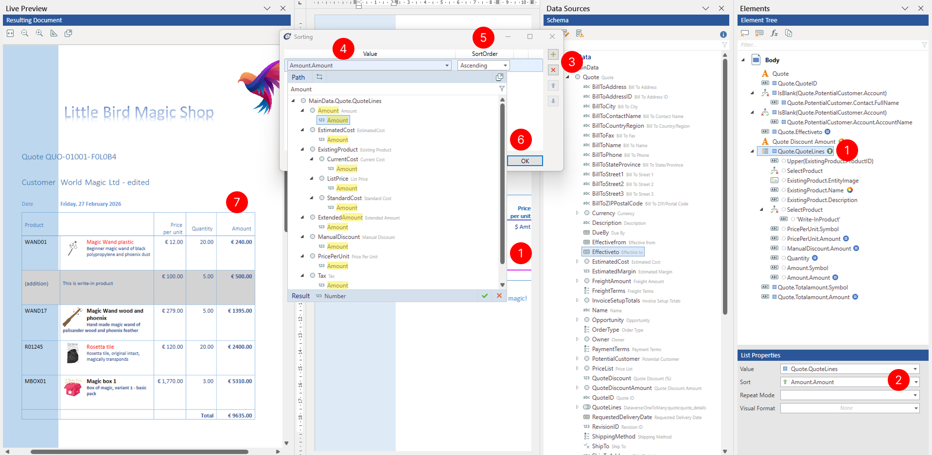

Configure sorting
Control the order in which list items appear in the generated document by adding sorting rules.
- Select the List tagging element to view its properties.
- In the Properties pane, locate the Sorting property and choose the sorting button to open the Sorting dialog.
- In the Sorting dialog, you can add multiple sorting rules to sort by multiple fields or remove sorting rules for how records should be ordered. Use the up and down arrows to change the priority of sorting rules.
- Select field Value based on which list will be sorted and choose the field or enter a PowerFx expression to use as sorting value.
- Select SortOrder to define whether to sort list in Ascending or Descending order.
- Choose OK to apply the sorting configuration.
- Review results in Live Preview pane.

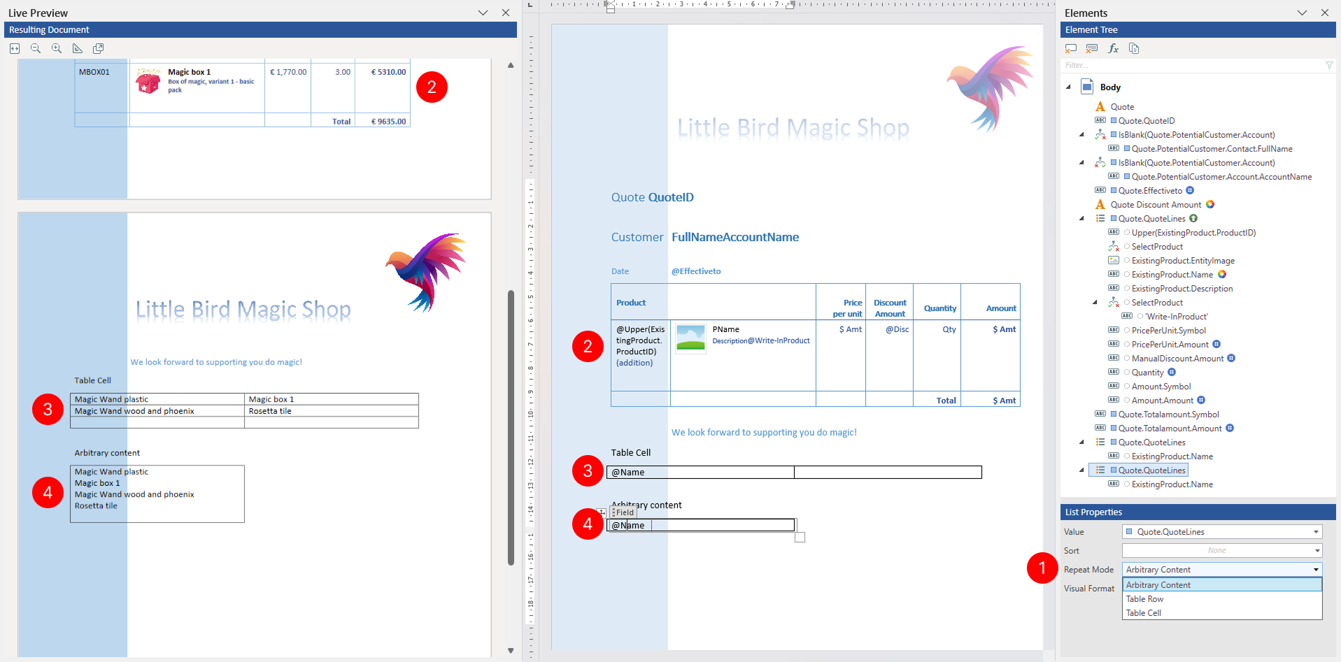

Configure Repeat Mode
By specifying the Repeat Mode property, you can control how the List tagging element repeats its content in the document structure. This is particularly useful when the List tagging element wraps different types of content, such as table rows, cells, or any other type of content.
- In the Properties pane, locate the Repeat Mode property and select one of the options. For example, if the List tagging element wraps an entire table row and you pick Table Row for the Repeat Mode, new table rows are created for each record in the collection.
- If the List tagging element wraps a single table cell, and you pick Table Cell for the Repeat Mode, new table cells are created for each record in the collection, in a left-to-right, top-to-bottom manner.
- If the List tagging element wraps a table cell, and you pick Arbitrary Content for the Repeat Mode, content for all records will be repeated and placed inside that single cell.
